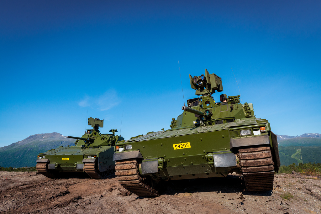

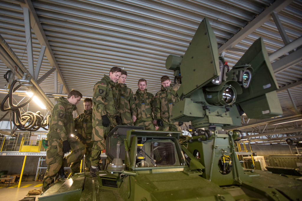

In Norwegen hat man eine fernbedienbare Waffenstation direkt hinter der Rohrwiege der Maschinenkanone angebracht. Die Software hat ein paar interessante Funktionen:
https://mediebank.ntb.no/p/forsvaret/al ... panservogn
In Norway, a version of the weapon station adapted to Nordic conditions is used, and it has become an important weapon and sensor platform on the Army’s upgraded CV-90 Infantry Fighting Vehicles.
The gunner, the commander and an operator can all control the weapon station. Furthermore, the weapon station can be used as a sensor for the vehicles’ main weapon: a 30 mm canon. The weapon station also has a greater angle of elevation than the main weapon, which is advantageous in urban environments.
https://www.kongsberg.com/newsroom/stor ... protector/

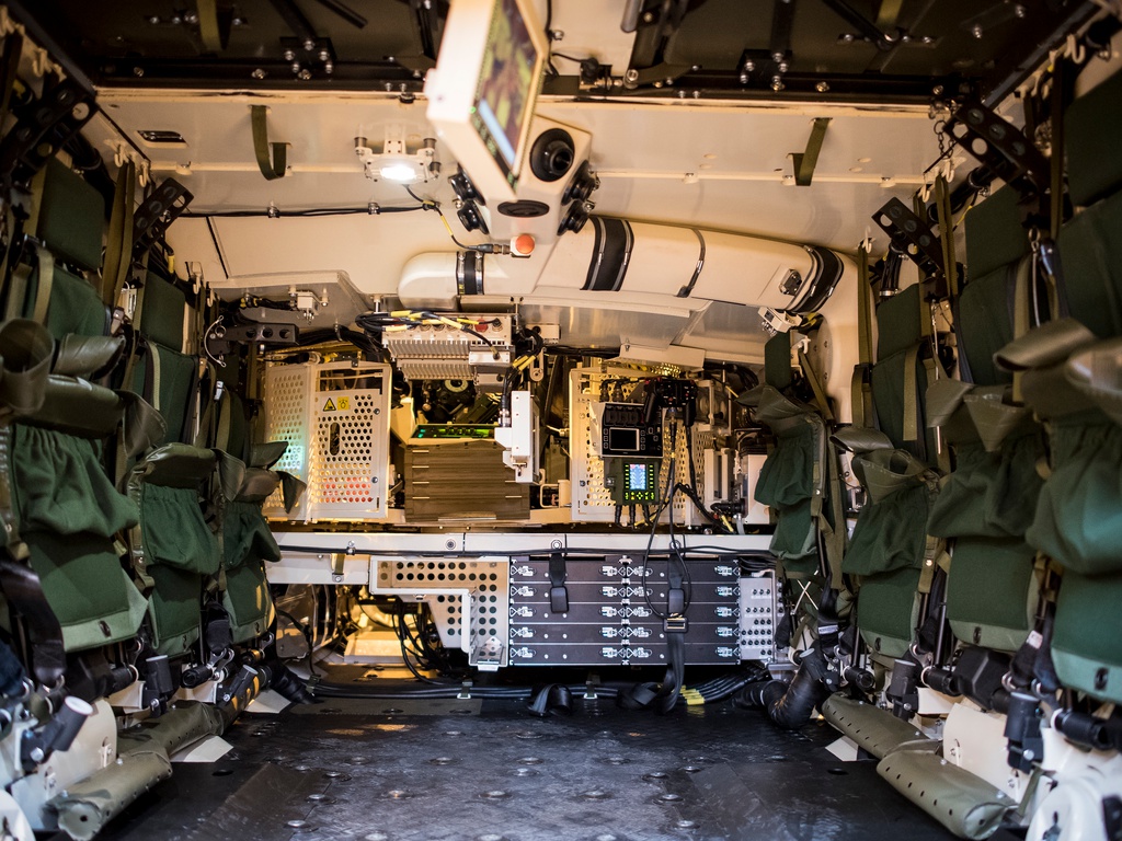

Die Fernbedienung für den "operator" sieht man im Mannschaftsraum, am Turmkorb hängend.

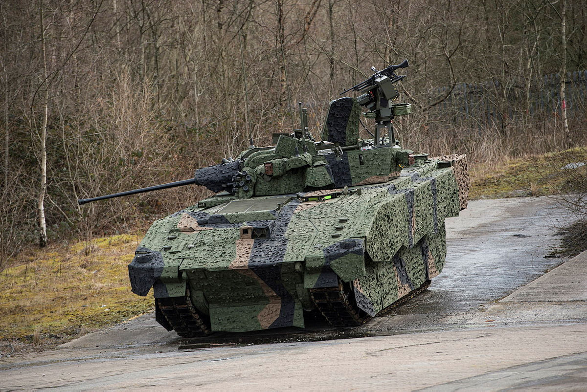

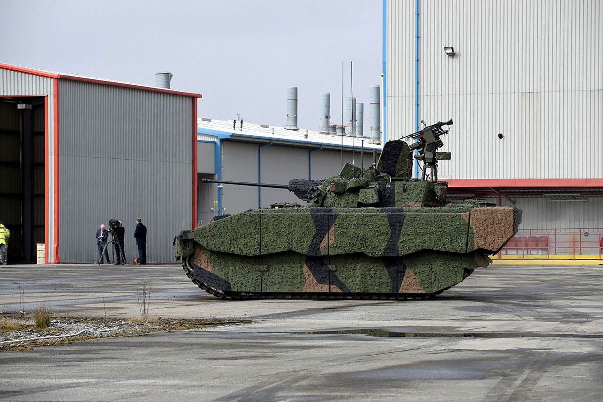

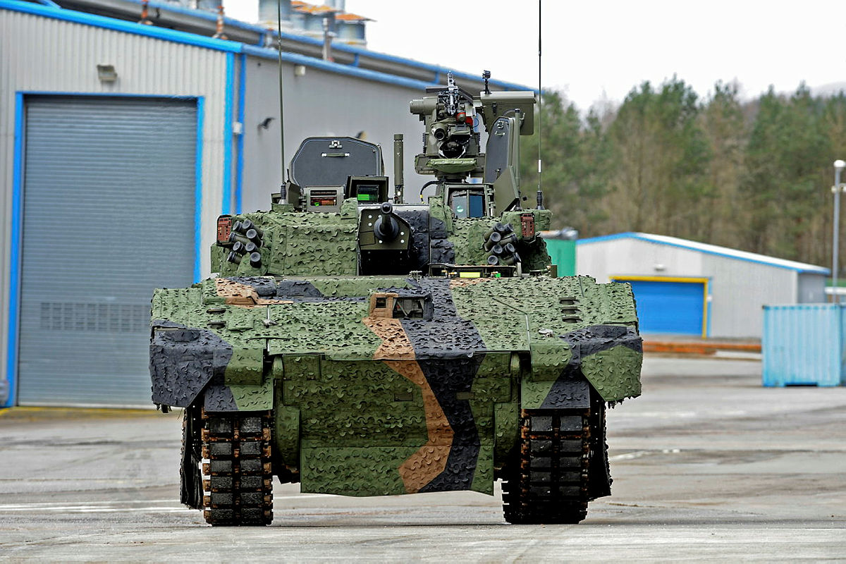

Ähnlich einem Vorserienfahrzeug für den Scout SV/Ajax:
https://www.defenceimagery.mod.uk/Home/ ... 2016-03-04
https://www.defenceimagery.mod.uk/Home/ ... onstration
Beim Serienfahrzeug hat man dann komplett darauf verzichtet.

Scout SV
https://defence-blog.com/ajax-programme ... ty-trials/
https://www.facebook.com/theroyalarmour ... 743277029/
