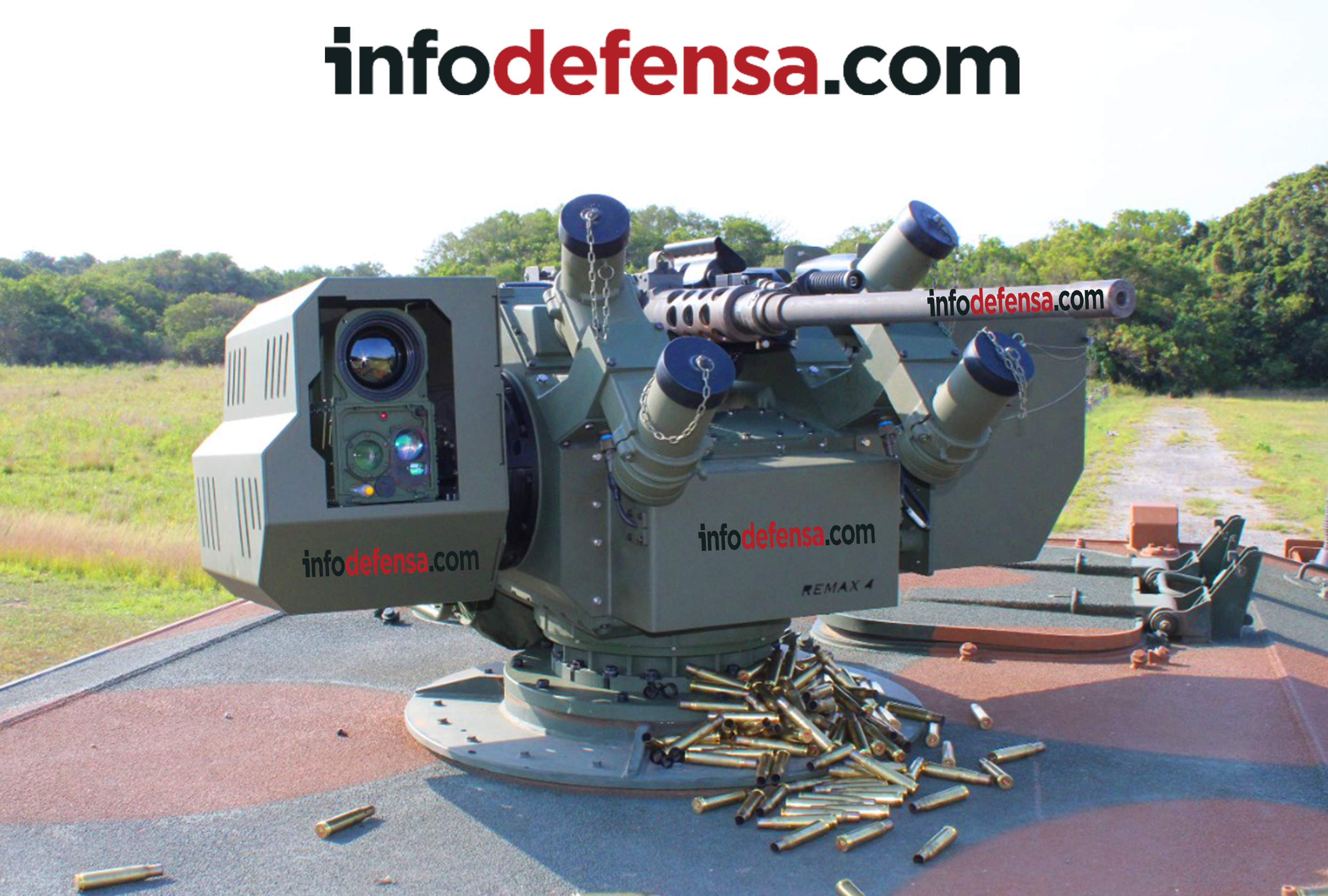

Doppeladler hat geschrieben: Mi 29. Dez 2021, 09:51Extrem kompakt aber weniger geschützt die Elbit-Lösung für Brasilien mit der Bezeichnung Ares REMAX - wohl eher nicht.
Quelle: https://www.defenseworld.net/news/18157 ... cwglWjMKUk
Das war ein früher Prototyp der ARES REMAX, Stand 2009:
https://defesaglobal.wordpress.com/2011/09/02/1013/
Informativo do CTEx nº 014
Reparo de Metralhadora Automatizado X (REMAX)
  • Conclusão da P&D: 2009
  • Previsão do início da avaliação: 2009
  • Demais etapas do ciclo de vida: em planejamento
http://www.ctex.eb.mil.br/component/pho ... &buttons=0
Informativo do CTEx nº 015
Informativo do CTEx nº 021
Die Serienversion sieht so aus:
http://www.cml.eb.mil.br/ultimas-notici ... izada.html
http://www.eb.mil.br/web/noticias/notic ... id/8330370
http://www.cml.eb.mil.br/ultimas-notici ... -ctex.html
Für die neue REMAX 4 hat die Herstellerfirma Anleihen in Österreich genommen (u.a. die Grundkonstruktion, Stabilisierung und automatische Zielverfolgung):
The REMAX 4, in development since late 2019 together with the Brazilian Army Technological Center, is suited for M2HB 12.7 × 99 mm and MAG58 7.62 × 51 mm machine guns.
Featuring automatic target tracking, the new RCWS measures about 690 mm high and weighs approximately 200 kg.
It utilises a low-profile dual-axis gyro-stabilised weapon mount with weapon cradle, ammunition feeding system, ammunition magazine for 300 12.7 × 99 mm or 600 7.62 × 51 mm rounds, four 76 mm smoke grenade launchers, in-house produced slip ring, ballistic computer, motion control equipment, and a fire-control system bay mounting a gyroscope unit and an OIP EOPTRIS 2.0 electro-optical imager. It also incorporates a day camera, uncooled thermal camera, and eye-safe laser range finder that are independent of the armament bay.
https://www.janes.com/defence-news/news ... eight-rcws
https://www.infodefensa.com/texto-diari ... rc-remax-4
