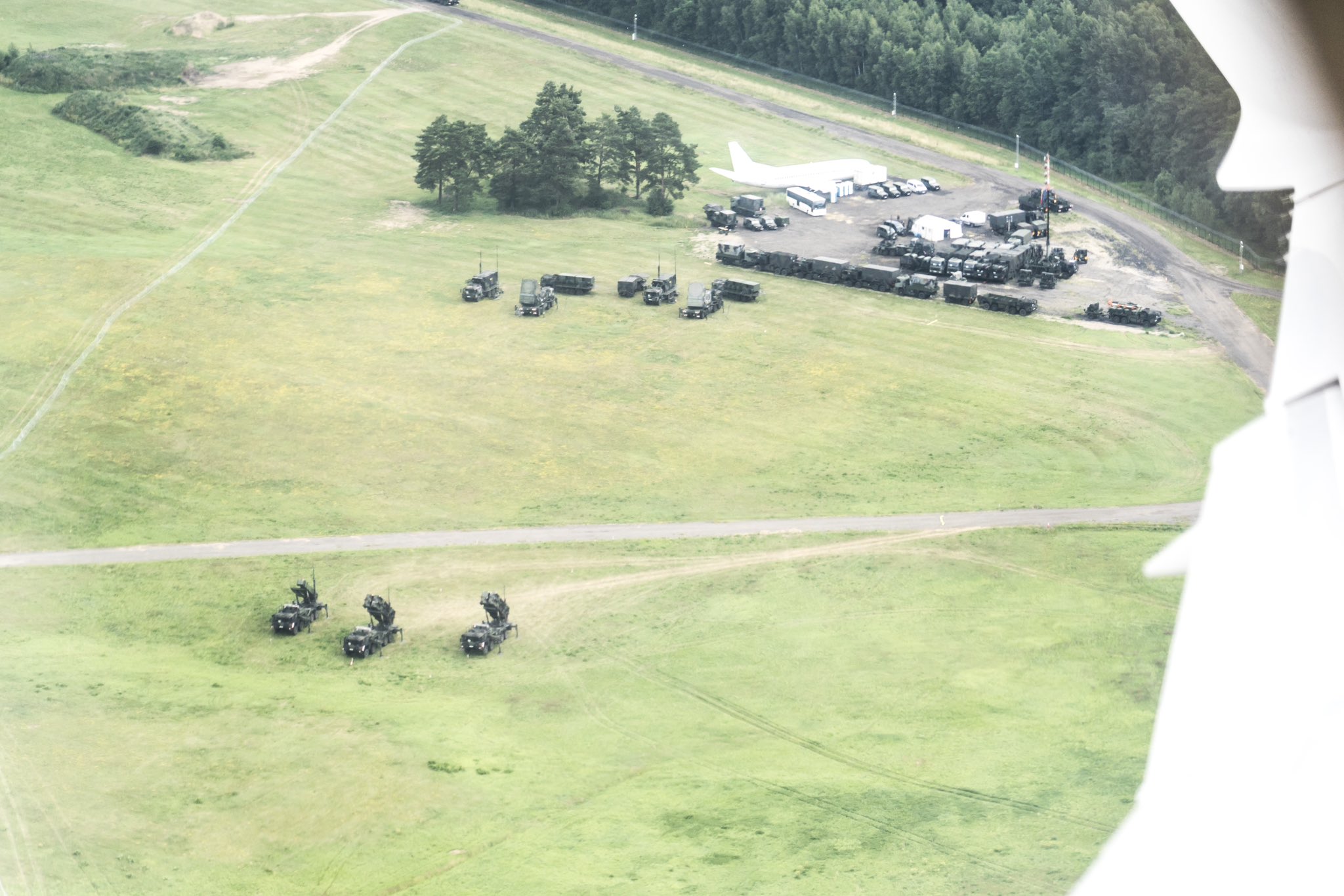

Desantnik hat geschrieben: Fr 18. Aug 2023, 21:11wie das alles nun bei modernen Systemen wie Patriot, IRIS-T SL, etc. aussieht wäre interessant...
Geländevorbereitungen werden dazu machmal umgesetzt, sind aber nicht unbedingt notwendig:
Construction workers level gravel at a NATO Patriot missile site in Gaziantep, Turkey, Jan. 24, 2013. U.S. and NATO Patriot missile batteries and personnel deployed to Turkey in support of NATO's commitment to defending Turkey's security during a period of regional instability. (U.S. Air Force photo by Tech. Sgt. Charles Larkin Sr.)
https://www.dvidshub.net/image/823369/p ... ent-turkey
https://www.dvidshub.net/image/863334/p ... ent-turkey
Hier vorbereitete "Patriot"-Stellungen in Taiwan:
Who to Protect? Taiwan's SAM Systems and the Distribution of Protection
https://sites.tufts.edu/gis/files/2017/ ... g_2017.pdf Bild
https://www.facebook.com/media/set/?set ... 617&type=3
https://www.facebook.com/media/set/?set ... 968&type=3
https://twitter.com/Team_Luftwaffe/stat ... 0799455232
https://www.facebook.com/forceaerienne/ ... 80/?type=3
https://www.facebook.com/photo.php?fbid ... 00.&type=3
