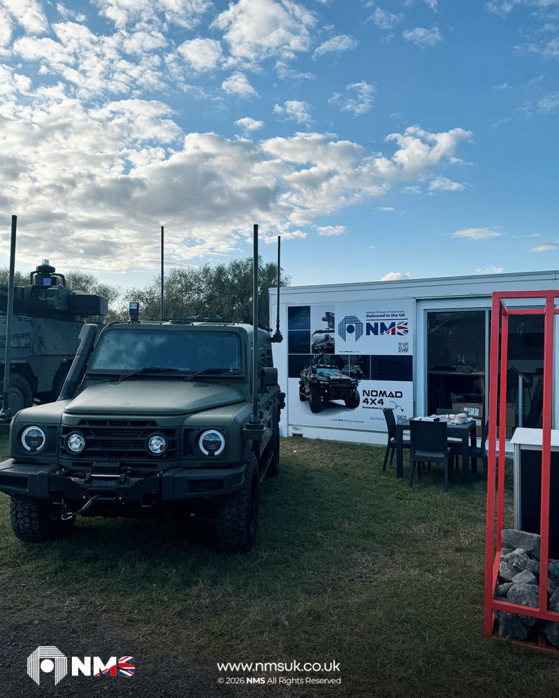

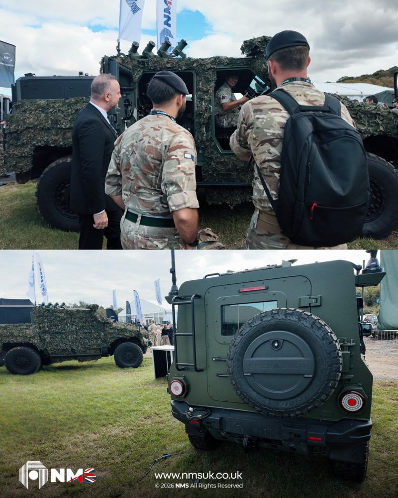

Ich habe noch ein paar Informationen zu diesem Fahrzeug aufgestöbert:
The Team Grenadier consortium has launched the Grenadier Enhanced Protection Vehicle, a new armoured variant of the Ineos Grenadier as it establishes its offering for the British Army’s Light Mobility Vehicle.
It is quite common for armoured variants of commercial off-the-shelf (COTS) vehicles to be produced; however, they are normally up-armoured versions of the COTS vehicle. This means that armour might be added to the existing doors and the windows replaced with armoured glass. This can only protect a vehicle to a certain extent.
In contrast, NMS UK has developed a brand-new armoured monocoque hull mounted on the rolling chassis of the Ineos Grenadier which they are calling the Enhanced Protection Vehicle. Built from armoured steel – which is presumably very hard – it provides ballistic protection to STANAG 4569 level 2.
If you aren’t familiar with STANAG 4569, level 2 basically means that the vehicle’s armour should be able to withstand a 7.62×39mm BZ armour piercing round, which is fired from AK-47 and Type 81 assault rifles. It can penetrate up to 12 mm of mild steel and usually requires hardened steel to defeat the high hardness steel core inside the projectile. The thickness, and therefore the weight, of the armour required to protect against a given threat depends on how hard it is.
The company Industeel, for example, recommends 13.5 mm of its Mars 380 steel or 10 mm of its Mars 550 steel at 0° obliquity to reach STANAG level 2. That difference in thickness would significantly impact the weight of the vehicle. So, it is reasonable to assume, given the margins of the Grenadier chassis, that the Grenadier EPV is using some very hard steel in its design.
STANAG level 2 protection also means that the vehicle must provide 90% protection including at the vehicle’s weakest points,
The team could not go into detail on the level of blast protection of the Grenadier Enhanced Protection Vehicle (EPV) but emphasised that it has a suspended floor and three-point harnesses. This helps to insulate the crew from the effects of a blast under the vehicle.
The vehicle weight is also under wraps for now, but it does retain the ladder chassis and automotives of the Ineos Grenadier with beefed up suspension. The added weight of the armour would impact its off-road performance in contrast to an unarmoured Grenadier, but not significantly.
De St John-Pryce added that by replacing the original doors with armoured steel, the Grenadier EPV actually provided more room than the original Grenadier for rifles and equipment.
https://www.calibredefence.co.uk/team-g ... d-vehicle/
https://www.linkedin.com/posts/nmsuk_dv ... 10786-E5XC
https://www.linkedin.com/posts/nmsuk_dv ... 68672-rbqi
https://www.linkedin.com/posts/nmsuk_te ... 36385-TISB
https://www.linkedin.com/posts/nmsuk_nm ... 31392-EFZV
https://www.linkedin.com/posts/nmsuk_nm ... 46272-YlUo
