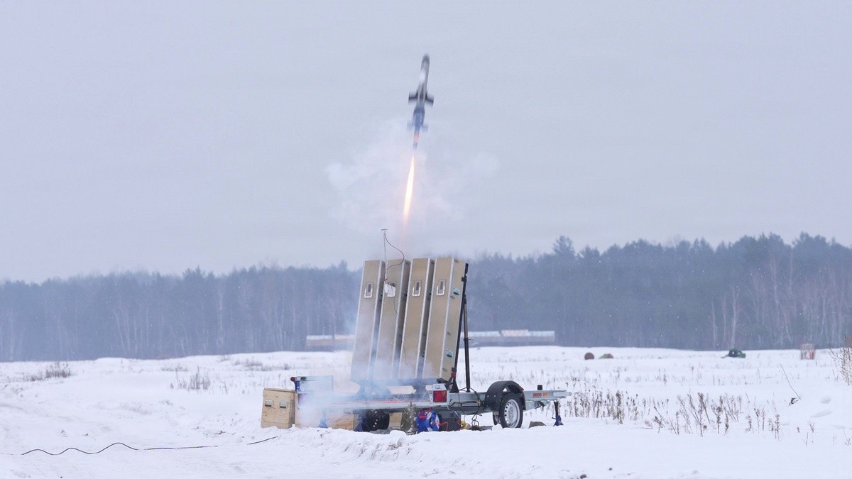

52d Air Defense Artillery Brigade (52d ADA BDE) is testing and evaluating new counter-Unmanned Aircraft Systems (c-UAS) capabilities, including IonStrike, a radar-agnostic, low-cost kinetic interceptor designed to strengthen layered defense against Unmanned Aircraft Systems (UAS).
IonStrike, produced by DZYNE Technologies, offers a potential new mid-range intercept capability for air defense formations facing increasingly complex UAS threats. The system integrates with existing command-and-control architectures, including the Forward Area Air Defense (FAAD) System and the Integrated Battle Command System Maneuver (IBCS-M), enabling Soldiers to employ the interceptor through systems they already use to detect, track, classify, and engage one-way attack drones.
During recent test and demonstration events this spring, DZYNE brought IonStrike to Europe and demonstrated its capabilities to senior leaders from USAREUR-AF and LANDCOM.
IonStrike is launched from a multi-interceptor pallet and is cued by radars already integrated into approved command-and-control (C2) systems. The test configuration uses a 4-interceptor launcher, and the brigade is working with DZYNE to field a 12-interceptor configuration to increase magazine depth against larger raid profiles.
Unlike traditional interceptors, which are typically expended after launch (fire-and-forget) and require one operator per target, IonStrike offers extended range and greater operator flexibility, especially against swarm threats. If a target is reclassified as friendly or no longer meets engagement criteria, the operator can abort the engagement or reassign it to another target. This gives commanders the ability to launch earlier, extend engagement depth, and preserve decision space without automatically losing the interceptor.
