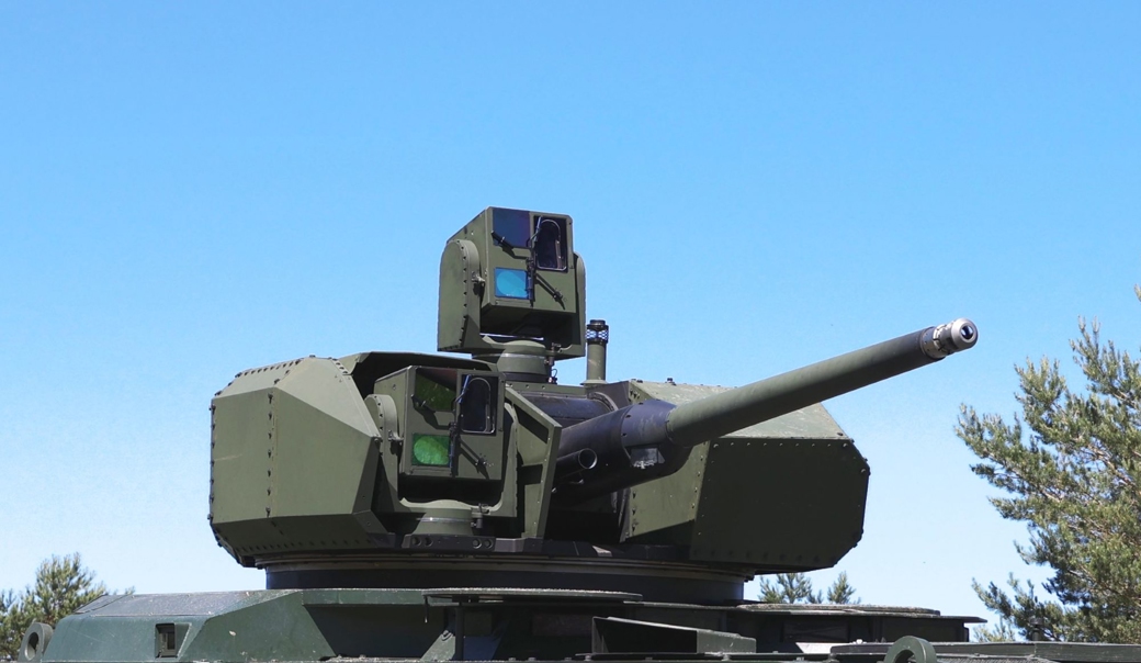

Die 16 Mrd. NOK betreffen nur einen Subauftrag an Kongsberg für die Teilkomponenten der fahrzeuggestützten 30 mm-Waffenstation PROTECTOR MCT30 und der fernbedienbaren Waffenstationen PROTECTOR:
theoderich hat geschrieben: ↑Fr 30. Jan 2026, 18:1970 mm-Lenkraketen APKWS
https://www.invariant-corp.com/containe ... pon-system
theoderich hat geschrieben: ↑Fr 30. Jan 2026, 18:1930 mm-Kanone Kongsberg
The contract is worth about NOK 16 billion to KONGSBERG. The programme, called SAN CUAS, entails the delivery of 18 CUAS batteries.
16 Mrd. NOK ... 1,4 Mrd. EUR
The system is based on KONGSBERG’s PROTECTOR family of weapon systems: the Medium Caliber Turret (MCT30) and Remote Weapon Station. The MCT30 is in full-rate production and the turret design characteristics: unmanned, light weight and fully digitalised, makes it well suited in a CUAS role.
The flexibility of KONGSBERG’s remote weapon stations enables the integration of various CUAS effectors. For the SAN program the RWS primary weapon will be the 70mm guided missiles. In addition, KONGSBERG will work closely with APS and PGZ to field flexible sensor and effector integration platforms for sub-system and vehicle integrations enabling distributed sensor and effector operations.
https://www.linkedin.com/posts/kongsber ... 95008-uXWl
