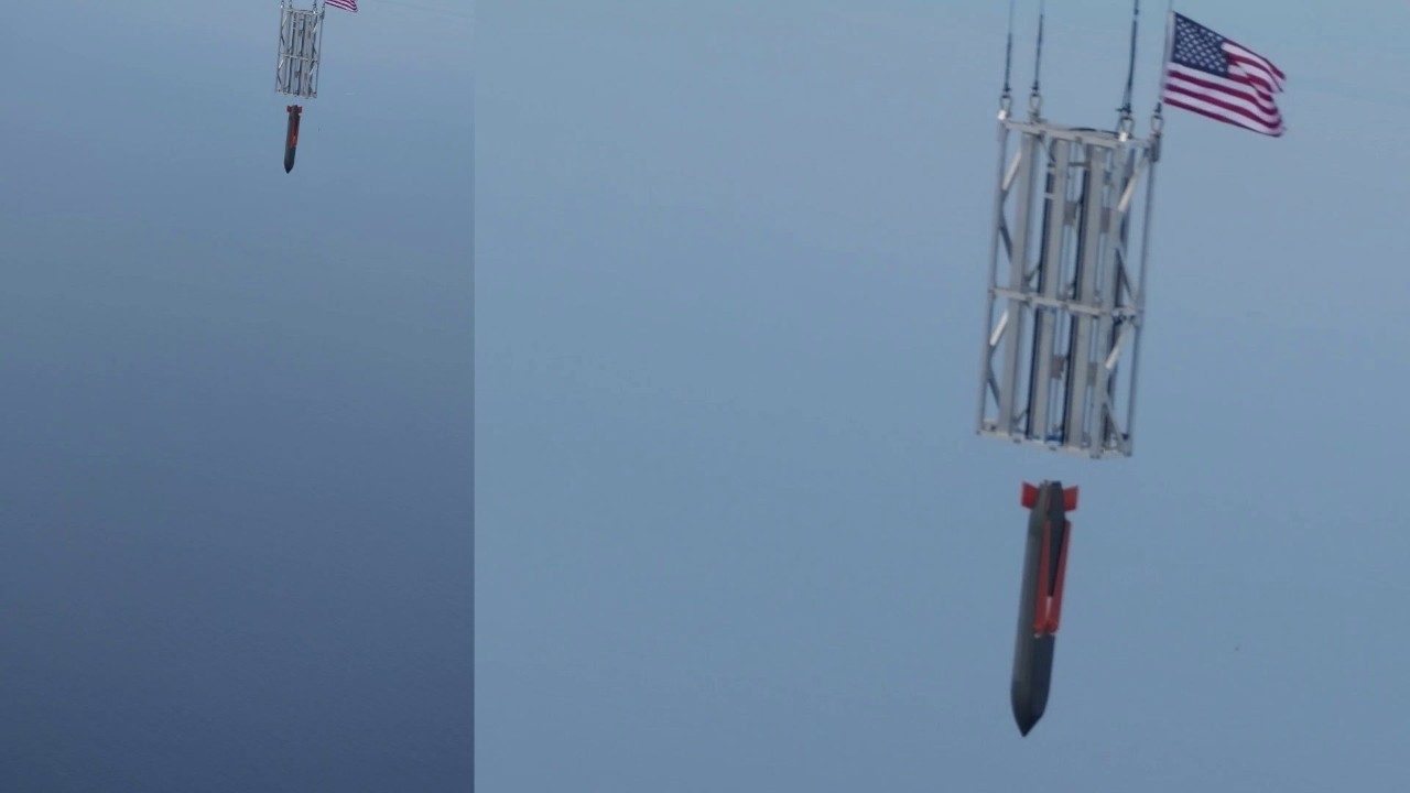

CMMT-D Deploys from Rapid Dragon Cell 
In May, a team from Orlando, Florida traveled to the Tillamook UAS Test Range on the Oregon coast to test CMMT-D, a compact cruise missile designed to deploy from air mobility aircraft like the C-130. They dropped a CMMT-D test missile from a Rapid Dragon pallet, which was carried by a helicopter to an altitude of 14,500 feet to simulate a parachute descent. The CMMT-D deployed its wings and entered an unpowered glide following a safe release.
The team plotted a swift development trajectory, achieving first flight in just 10 months from initial concept design. Par for the course for the award-winning team that put the “rapid” in “Rapid Dragon” by getting palletized effects to the same milestone from a clean start, also in 10 months.
Rapid Dragon has deployed fielded cruise missiles over several years of demonstrations. This was its first deployment of a compact air vehicle in a tactically representative airborne environment.
 CMMT-X Air-Launches from Pylon 
In June, a CMMT team from Palmdale, California, traveled to the Pendleton UAS Range in Oregon to test CMMT-X, a smaller variant of the CMMT family. They mounted CMMT-X to the pylon of a test aircraft and took to the skies for CMMT’s first pylon launch from an airborne aircraft. The vehicle safely separated from the launch craft, deployed its wings and lit its engine to initiate powered flight.
