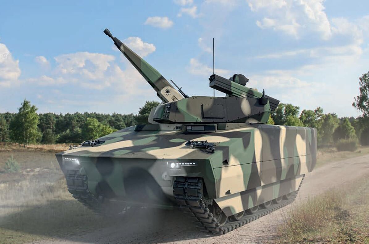

Rheinmetall Air Defence: Mobile Firepower. OERLIKON SKYRANGER MOBILE AIR DEFENCE SYSTEM (Mai 2022) hat geschrieben:SKYRANGER35
The Skyranger35 consists of a remote-controlled 35mm gun turret with an integrated sensor suite as well as operating consoles and additional modules (e.g. power supply, electrical distribution, accessories) in the vehicle. The entire system is designed to be very modular and therefore allows simple integration into different carrier vehicles. The gun turret is designed as a complete, compact and modular air defence system. It provides a powerful remote-controlled 35mm revolver gun with a high rate of fire of up to 1,000rpm and is equipped with a link-less feed system containing 252 rounds. Reloading is carried out via the loading gate at the back of the turret or optionally from inside the vehicle. The sensor unit at the rear of the turret is equipped with multiple sensors allowing the precise tracking of air or ground targets. The sensor unit combines active and passive sensors. The XTR20 tracking radar is optimized for small targets and all-weather performance. The electro-optical sensors (IR camera, HDTV camera, two laser range finders) allow passive target tracking and identification.
The Skyranger35 is operated with two consoles inside the vehicle; one C2/commander console and one target operator/gunner console. The commander console provides the local air picture and the link to the Skyranger Control Node 1. The target engagements and the operational status of the gun turret are controlled from the gunner console. The two consoles are redundant and allow operation of the complete Skyranger 35 from a single console in case of emergency. For improved situational awareness, the complete ground picture can be displayed to the crew on additional screens. The operation of the system is highly automated and intuitive.
Due to its modularity, the 35mm gun turret and additional system modules can easily be integrated into different types of wheeled or tracked vehicles. Air targets are engaged while the vehicle is stopped. Ground targets can be engaged on the move.
MAIN FEATURES
  • Mobile 35mm air defence gun
  • Effective combat range: up to 4,000m
  • 35mm Oerlikon Revolver Cannon® KDG
  • Nominal rate of fire: 1,000rds/min.
  • Rapid single-shot mode: 200rds/min.
  • Ahead airburst ammunition
  • Ready-to-fire ammunition: 252 rounds
  • Remote charge and discharge function
  • Ku-band tracking radar
  • Fully stabilized electro-optical sensor unit
  • Automatic target handover and tracking
  • Two redundant operator consoles in vehicle
  • Integrated navigation system
  • Multi-purpose missions
  • Simple handling and maintenance
  • Integrated AESA search radar
PERFORMANCE OF REVOLVER CANNON KDG
Rate of fire up to 1,000rds/min
Muzzle velocity 1,050m/s
Muzzle power ~7MW
CHARACTERISTICS
Mass 405kg
Length (total) 4,110mm
Recoil force (mean) 15,000N
Recoil movement 20mm
