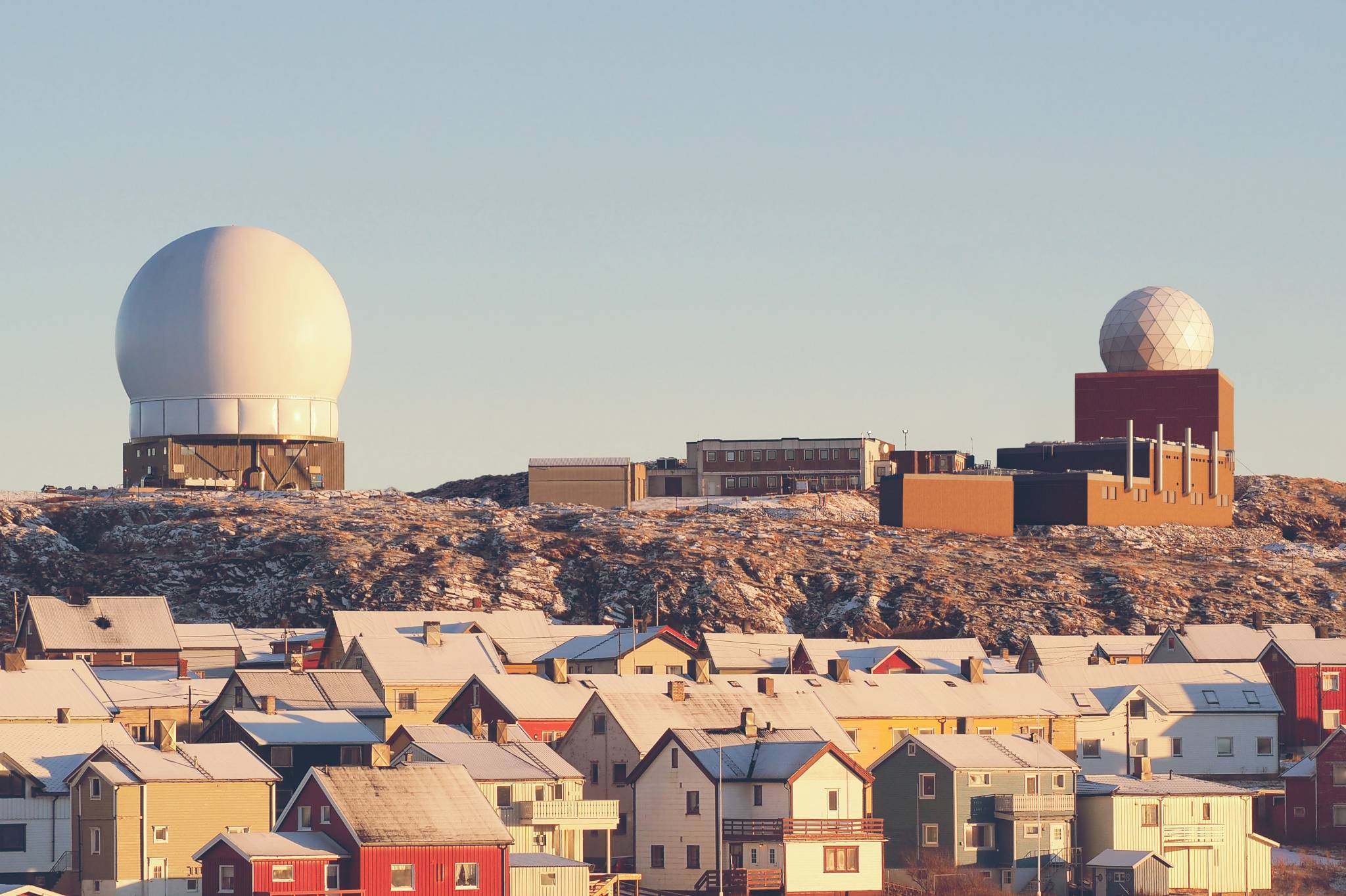

Das amerikanisch-norwegische Radarsystem GLOBUS in Vardø ist seit den 1950er-Jahren im Einsatz und in das US-Raketenabwehrsystem eingebunden:
https://www.etterretningstjenesten.no/a ... s-systemet
https://www.esa.int/esapub/bulletin/bul ... inkrad.pdfFylingdales
The most powerful space surveillance sensor in Europe is located in Fylingdales (UK) and is operated by the British armed forces. Most of the activities are geared to the US Space Surveillance Network (SSN) early warning and space surveillance mission.
Technical specs: The Fylingdales complex consists of a high-performance 3-face, phased-array radar operating in the UHF-band. Technical details not openly available.
Globus II
A second facility associated with the US SSN is the Norwegian Globus II radar. It is located in Vardø, at the northernmost tip of Norway. Due to special bilateral agreements between the US SSN and the operators of Fylingdales and Globus II, data from these sites have so far not been available for unclassified use within Europe.
Technical specs: Globus II is an X-band mono-pulse radar, with a 27 m parabolic dish antenna, housed in a 35 m radome.
