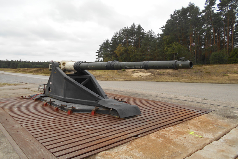

Two stages down, three to go with MGCS
Two phases of MGCS have been completed (Operational Needs Analysis and Concept) with three to come: Development and Technological Capability Demonstration; Integration and System Demonstration; and finally System Production from around 2035.
While its current incarnation is Franco-German, the door may open for other countries to join MGCS with Poland already indicating a strong interest, but as with all previous internal MBT programmes, there are still potential pitfalls when it comes to prototype and production workshare.
During the Concept phase, fine tuning of four developed platform concepts took place.
The first of these four was a single-concept tracked platform with a large-calibre externally mounted gun - potentially the Rheinmetall 130mm smoothbore gun launched in mid-2016 which has already begun firing trials (pictured), or the older 140mm Future Tank Main Armament which was a joint French/German/UK/US programme cancelled after the end of the Cold War.
This could be similar to the Russian T-14 Armata MBT, which is armed with an externally mounted 125mm gun fed by an automatic loader with all the crew (commander, gunner and driver) seated at the front of the hull for maximum protection.
The second is also a single platform concept with a laser, missile launcher or another advanced weapon system as the main armament instead of a gun.
The others included a multi-platform wheeled (probably 8x8) concept in manned and unmanned configurations with different sensors and effectors.
In addition to being used as a follow-on to the Leclerc and Leopard 2, the platform selected for MGCS could also be used for at least one element of the projected Common Indirect Fire System.
This would replace the German PzH 2000 155mm/52 calibre tracked self-propelled (SP) artillery system and the French CAESAR 155/52 wheeled SP artillery system.
https://www.shephardmedia.com/news/land ... news_promo
