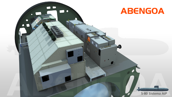

Erst die S-83 und S-84 werden mit dem ABENGOA Bio-Ethanol Stealth Technology - Air Independent Propulsion (BEST-AIP; Sistema de Propulsión Independiente de la Atmósfera) ausgestattet sein. Das neue Antriebssystem wird bei S-81 und S-82 während der ersten planmäßigen Dockwartung nachgerüstet.
  • UDT 2019 – Platform Design for leading edge AIP submarines
    Abstract — The object of this paper is to describe the silent propulsion mode for the new S-80 Submarine programme awarded by the Spanish Ministry of Defence to Navantia.
    https://cdn.asp.events/CLIENT_Clarion__ ... -Paper.pdf
The AIP System consists of several main equipment: Bioethanol Processor System (BPS), Fuel Cell Power Module (FCPM), Power Conditioning System (PCS), CO2 Disposal System (SECO2) and AIP Control System (AIPCS). Abengoa is in charge of the design, manufacture and validation of several of these main equipment (BPS, PCS and AIPCS), as well as the integration of the FCPM and SECO2 to guarantee the required performance, functionality and operability.
https://www.abengoa.com/web/en/noticias ... 00601.html
Collins supplies a 300 kW fuel cell power module for the Spanish S-80 submarine. The unit is part of Navantia’s Bio-Ethanol Stealth Technology (BEST) AIP system and runs on bioethanol reformate and oxygen. Our system provides best-in-class endurance and stealth, increasing submerged operation time from 3 to 21+ days.
https://www.collinsaerospace.com/what-w ... er-Systems
