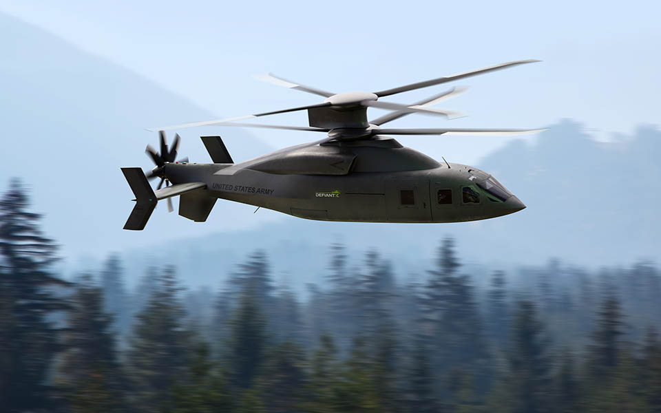

Sikorsky-Boeing unveil Defiant X for US Army’s FLRAA programme
DEFIANT X
https://www.lockheedmartin.com/en-us/pr ... ant-x.html
http://www.boeing.com/defense/future-lo ... index.page
https://www.flightglobal.com/helicopter ... 95.articleA Sikorsky-Boeing team has unveiled Defiant X, its design proposal for the US Army’s Future Long Range Assault Aircraft (FLRAA) programme.
The helicopter has a rigid coaxial rotor system and pusher propeller and thus is almost identical to its demonstrator predecessor, the SB-1 Defiant. However, some small changes to the production model’s configuration are planned, Sikorsky and Boeing said in a 22 January interview.
Most noticeably, the helicopter’s exhaust outlets have been covered with a shroud to reduce its infrared signature, a precaution against heat-seeking missiles. The rotorcraft’s landing gear configuration was changed from two mid-section wheels and a tail wheel to a layout that includes a nose wheel, two mid-section wheels and a small wheel under the tail.
“We’ve made some changes to the landing gear for a tricycle design landing gear, which improves both stability, but then landing and taxiing in combat and austere environments,” says Heather McBryan, Boeing’s sales and marketing director of Future Vertical Lift.
The trailing edge of the vertical stabilisers on the SB-1 Defiant have also gone from straight to a V-shape. The Sikorsky-Boeing team declines to say why this was done, other than to explain it was to enhance performance.
The Sikorsky-Boeing team says the internal electronics and hardware of the rotorcraft have been refined, but large parts such as the transmission remain unchanged from the SB-1.
